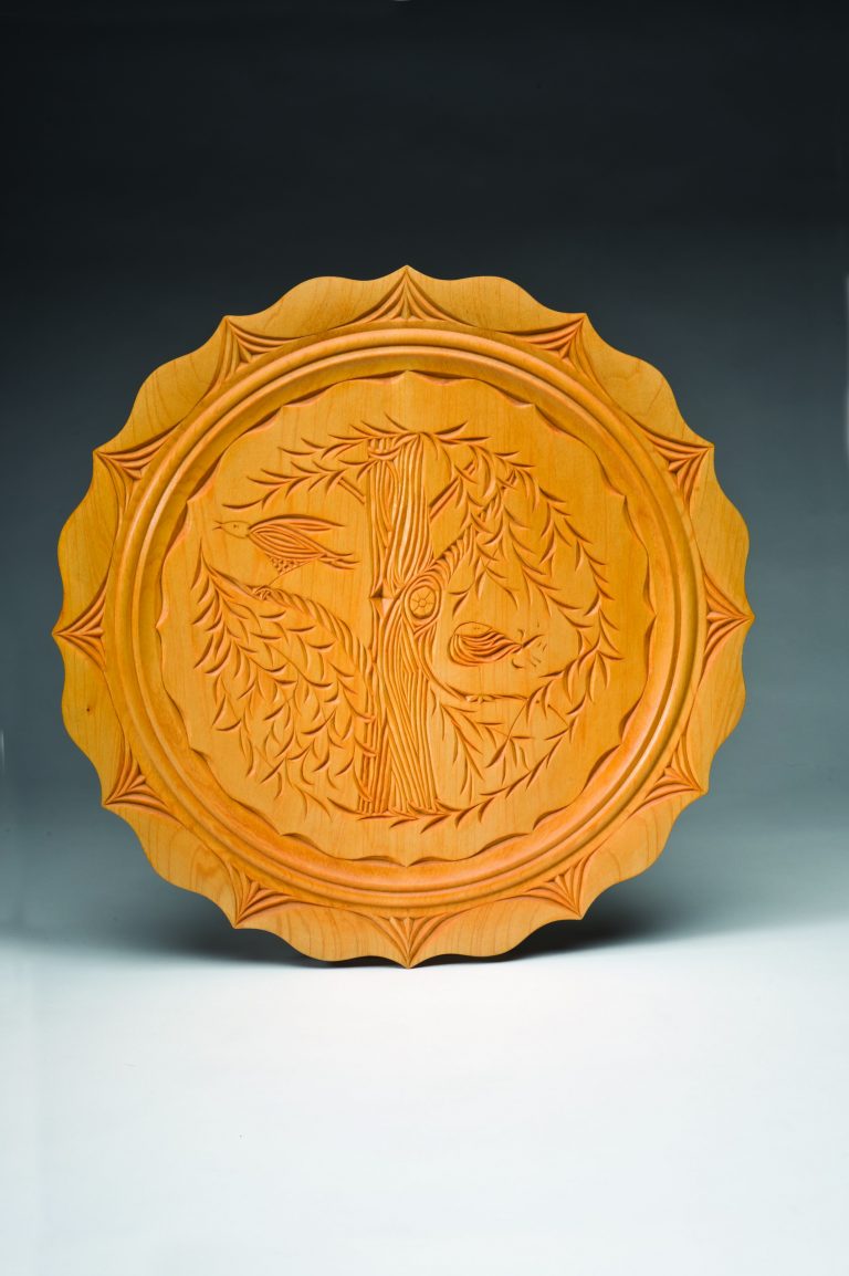

Like dividers, a compass has two straight legs; however, one leg holds a pencil or other writing implement. A compass is often used to draw circles, which are common in geometric carvings and chip carvings. A compass is useful to mark regular distances, such as the points on a geometric chip carving. I also use a compass to mark the depths of the different layers in a relief carving.
