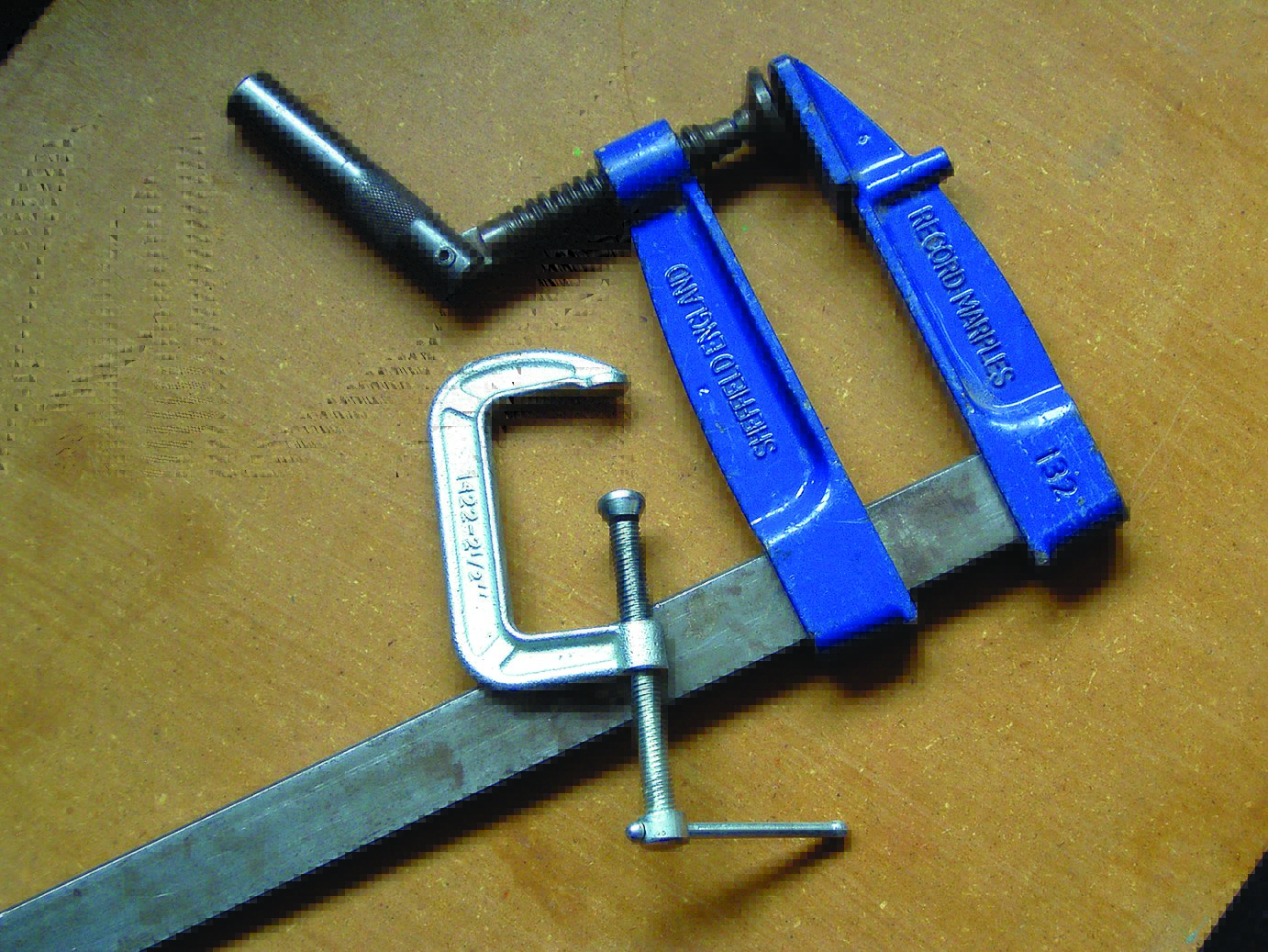

- ‘C’ Clamps: These and a regular woodworking bench vise are standard fare in most workshops. Why? Because they are so useful! It’s very satisfying to use these unassuming pieces of equipment and a few bits of wood to find a simple solution to holding your carving.
