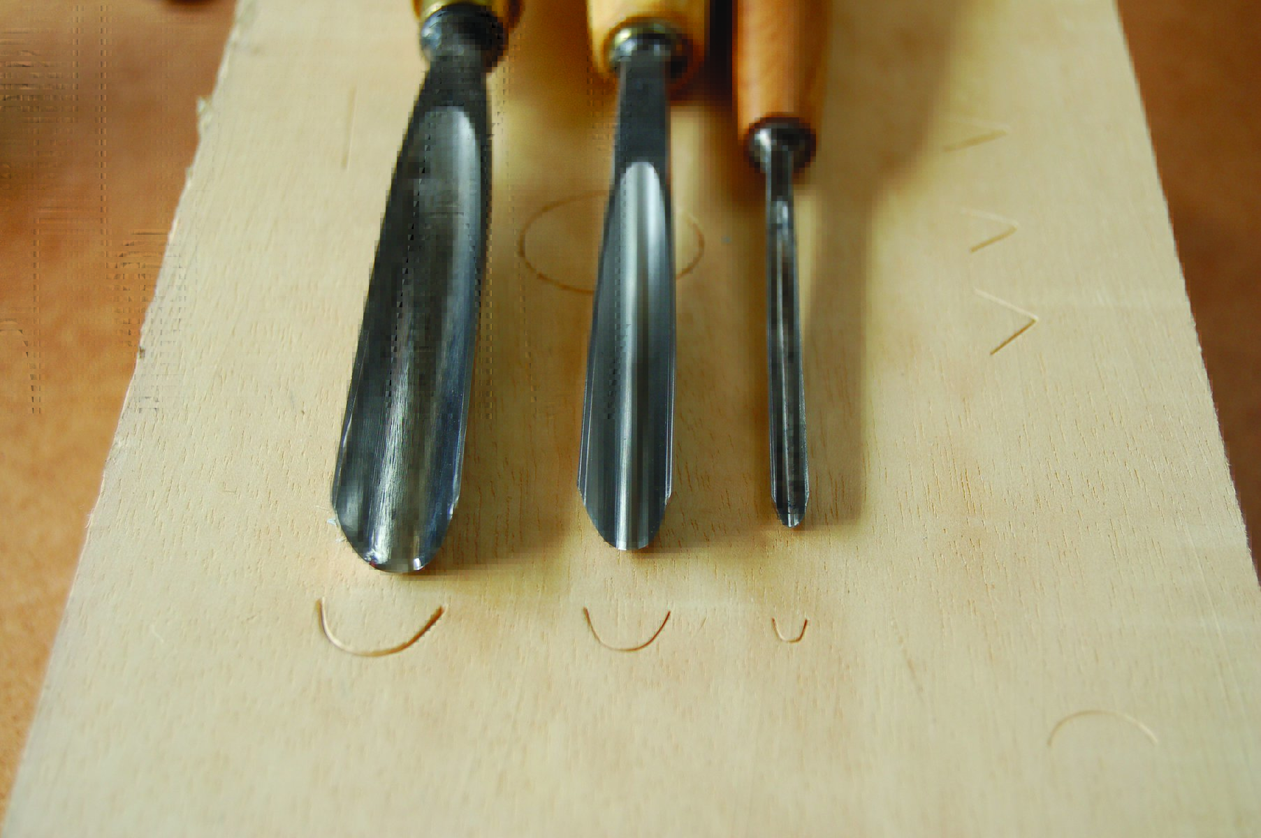

You have probably seen these charts in tool catalogs and carving books: you are looking at the profiles of carving tools seen on end, what carvers call their sweep. The sweeps and longitudinal shapes of carving tools are collected by manufacturers into numbering systems.
Regular Gouges
In a ‘true’ gouge, the sweep is actually an arc of a circle, a fact that can be readily demonstrated. The bigger the circle from which the arc is taken, the flatter the gouge.
The width of a gouge is measured from corner to corner. This width or size of the tool is classified in either inches or millimeters. For any given width, there is a range of flatter or deeper (quicker) gouges. The deepest true gouge is a semicircle.
Carvers use the fact that gouges are circle driven to great advantage when they produce perfect flowing lines by rotating the cutting edge along the sweep; cuts that can be unfailingly repeated elsewhere. This is very important in, say, mouldings, or matching two sides of a face. Gouges are the very bedrock of carving, from roughing out to finishing off.
U-Gouges
What I call ‘U-gouges’ are similar to true gouges, but work in a fundamentally different manner. The base of the “U” is a semi-circle or deep curve, but the walls extend upwards, parallel or splaying slightly, which means that you cannot rotate the cutting edge through an arc as you can with a true gouge.
These tools are used for creating channels or flutes when large (and are thus called fluters) and running the sort of detail lines you find in hair, fur or leaves when small (in which case they are called veiners). Broader U-gouges are great for roughing out and general shaping as you can mix the quickness of a deep gouge with flatter sides.

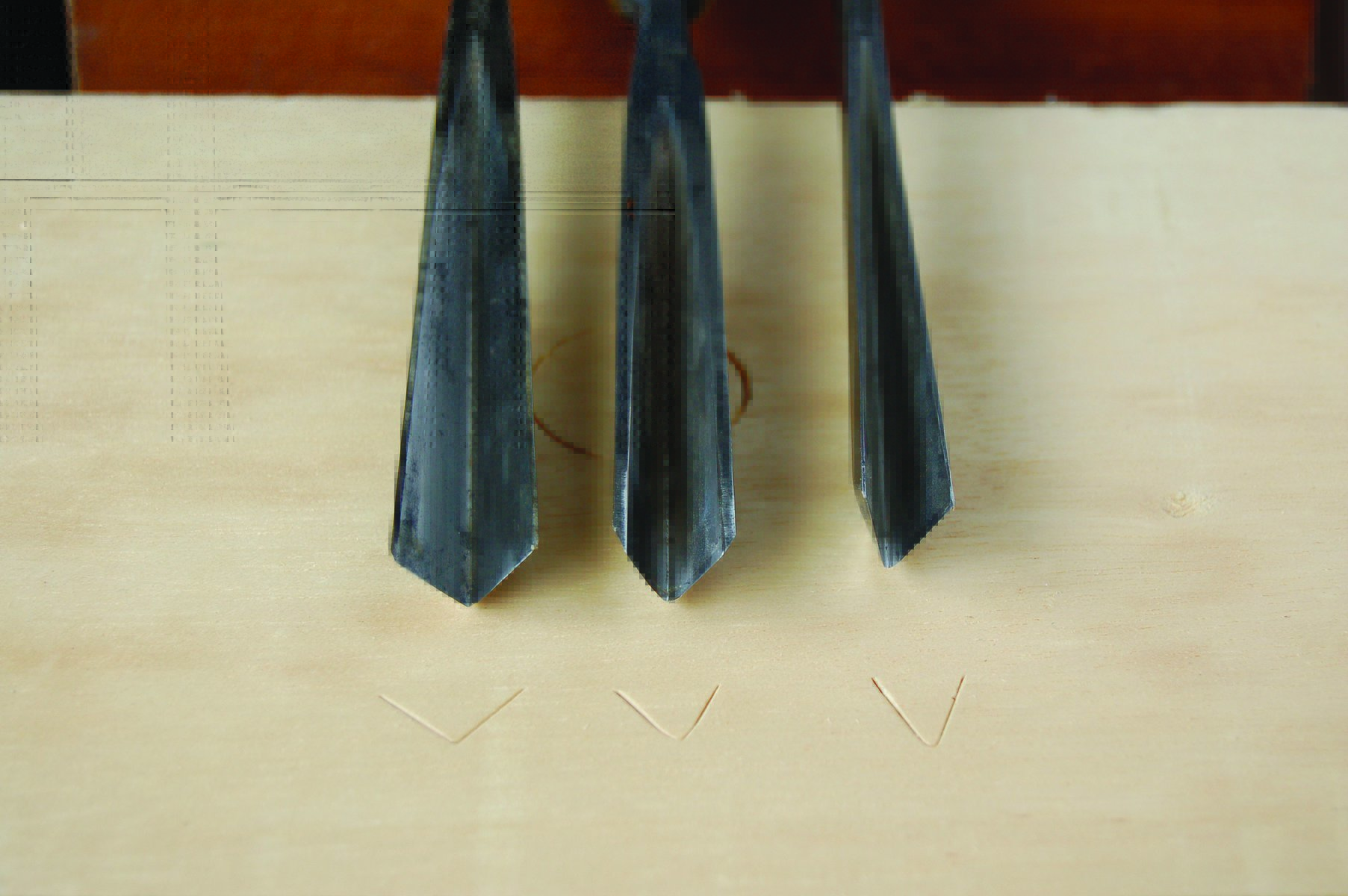

V-Gouges
In the charts you will also see sweeps that look like a “V”: these are called “V” or parting tools. The tool consists of two chisels joined at an angle that varies from 45˚ to 90˚, with 60˚ being the most useful. You would use the V-tool for separating (parting) one element in a carving from another, or for drawing lines, somewhat like a veiner.

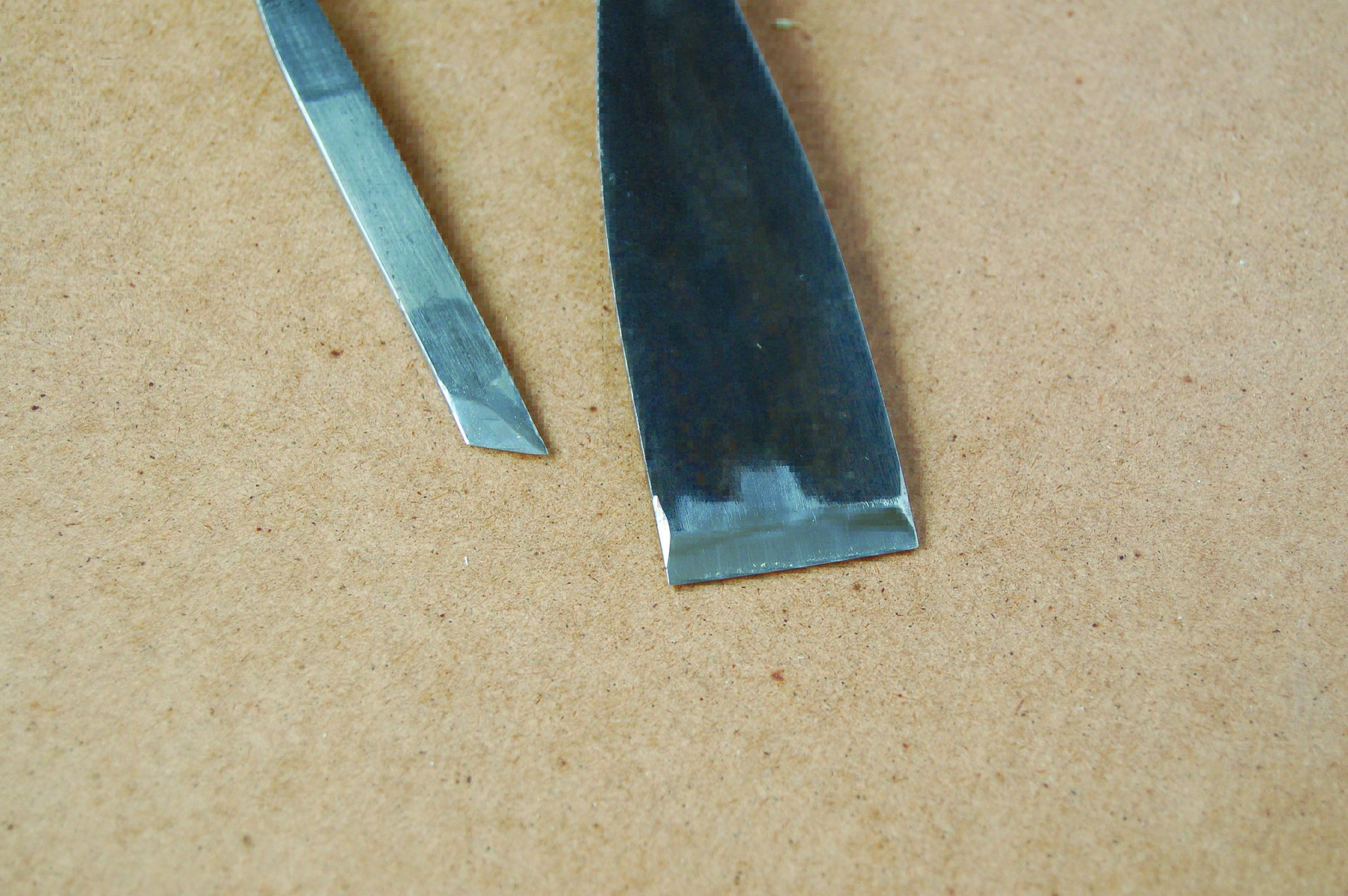

Chisels
Lastly in the charts you will see chisels—dead flat like a carpenter’s chisel, but with a bevel on both sides—and skew chisels—angled at the end to produce a knifepoint and also with a bevel on both sides.
Chisels are used for lettering in the traditional manner. Skews are one of those tools I don’t use often, but when I need it, nothing else will do. They are useful for getting into tight corners, cleaning junctions and lines. The double bevel is an important feature, but we will delay discussing this until we look at sharpening.

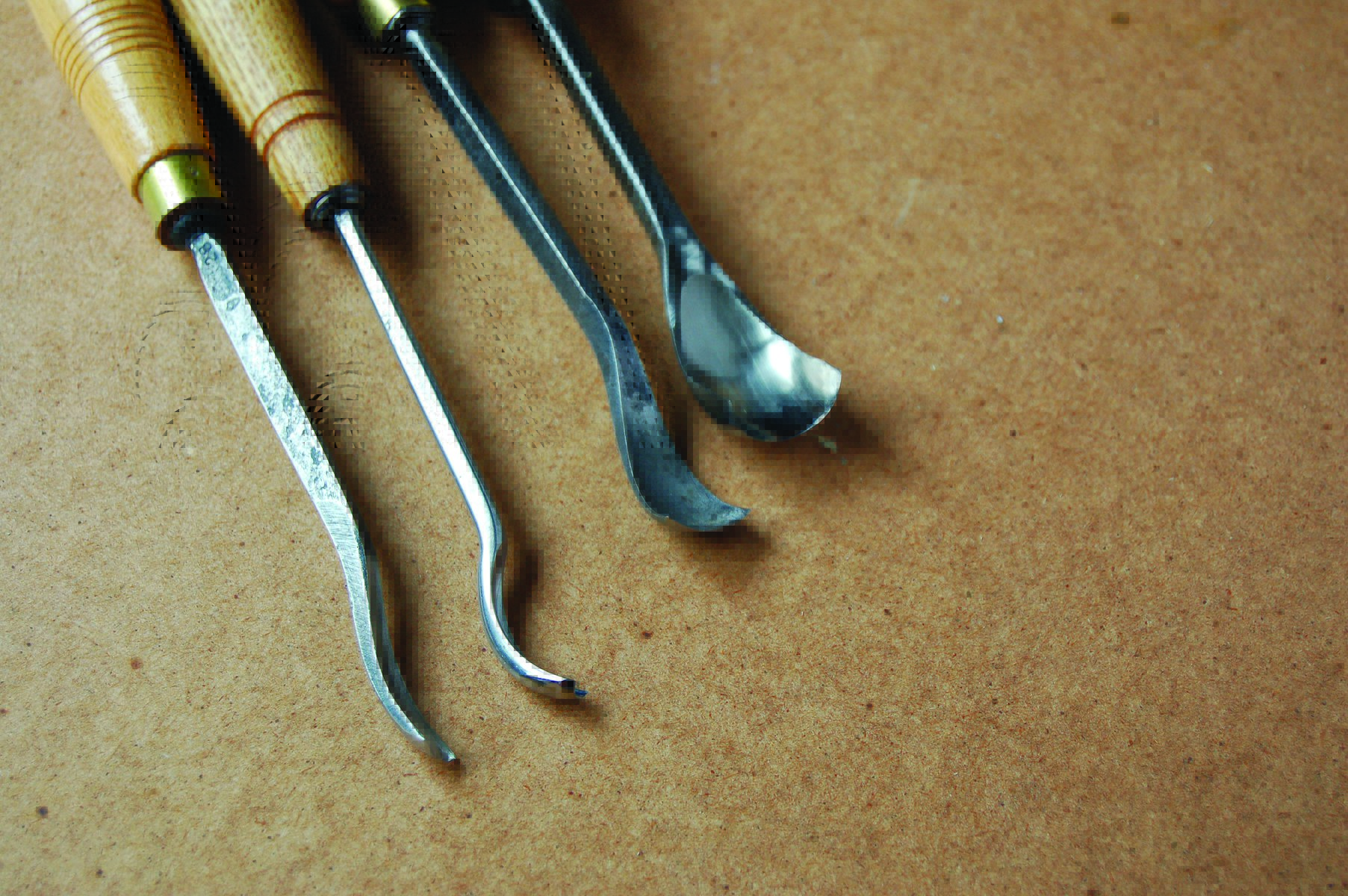

Bent Gouges
Thinking about how students seem to progress: next in usefulness are bent gouges. There comes a time when a regular gouge cannot get deep enough into a hollow; the blade fouls the edge. At this point a carver turns to a gouge that looks more like a spoon to get into the recess and scoop the wood away. These tools are called shortbent or spoon gouges. There is no standard bend and you need to see if a particular manufacturer makes the shape you want.

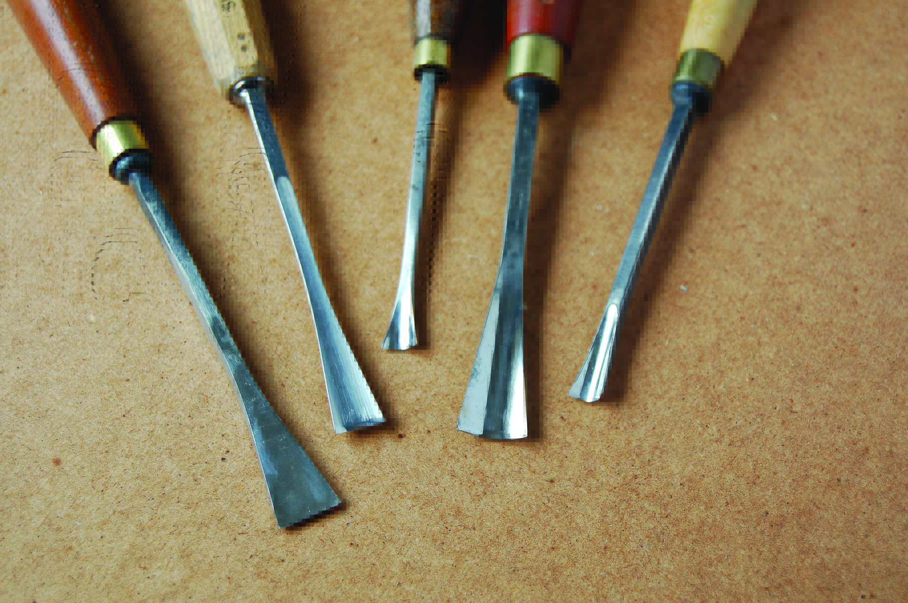

Fishtails
The next most useful tool is the fishtail. The blades of fishtails splay out from the end of a long shank. Again, manufacturers differ in the actual shape or amount of the splayed blade.
Unlike regular gouges, you can imagine that fishtails will eventually narrow as you sharpen them, giving them a shorter lifespan. Being more delicate and short-lived, carvers normally save fishtails for light work: finishing off and detailing, or running the protruding fishtail corners into recesses that would be inaccessible to the square corner of a regular gouge.
