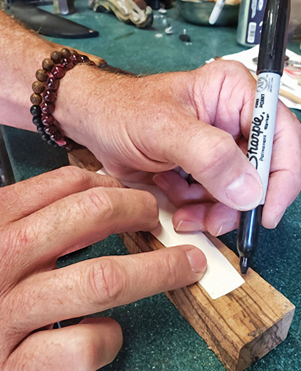

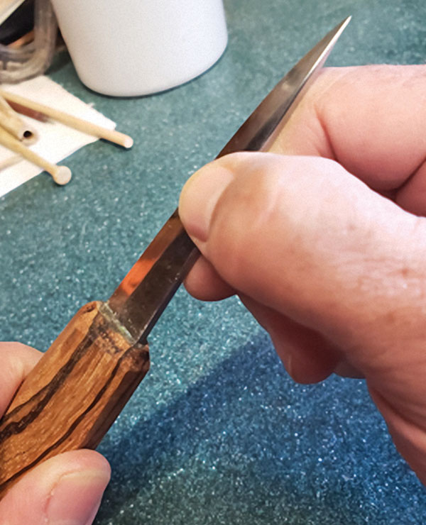

To make your own handle, first select the wood you wish to use—I used a piece of zebrawood because of its beautiful grain. Use either a coping saw or a band saw to cut out the handle. Then use a belt sander or wood files and sandpaper to smooth and shape it to size. Most carving blades are not full tang, meaning they have a short, flat extension into the handle. A full tang extends the length of your handle. Most Mora blades have a long tang, but I chose to cut mine shorter to about 2″ (5.1cm) long. Since the Mora blade is flat, I cannot just drill a hole and glue the blade in—I need to mark the width of the blade on one of the ends of my handle (select a drill bit slightly larger than the thickness of the tang) and drill a few close holes along the line. Clean out the thin pieces of wood between the drill holes. Apply a thin layer of epoxy to the blade tang and a little down into the hole. Slide the blade in and wipe away any excess with a rag. Let dry. Add a coat of finish to the handle and strop the blade. Check for a secure git and no wobbling before you begin to carve. |
Create a template and trace the design on the wood running with the grain.Make a handle from a simple piece of oak, or deck out a “dream blade” with a piece of exotic hardwood. |
